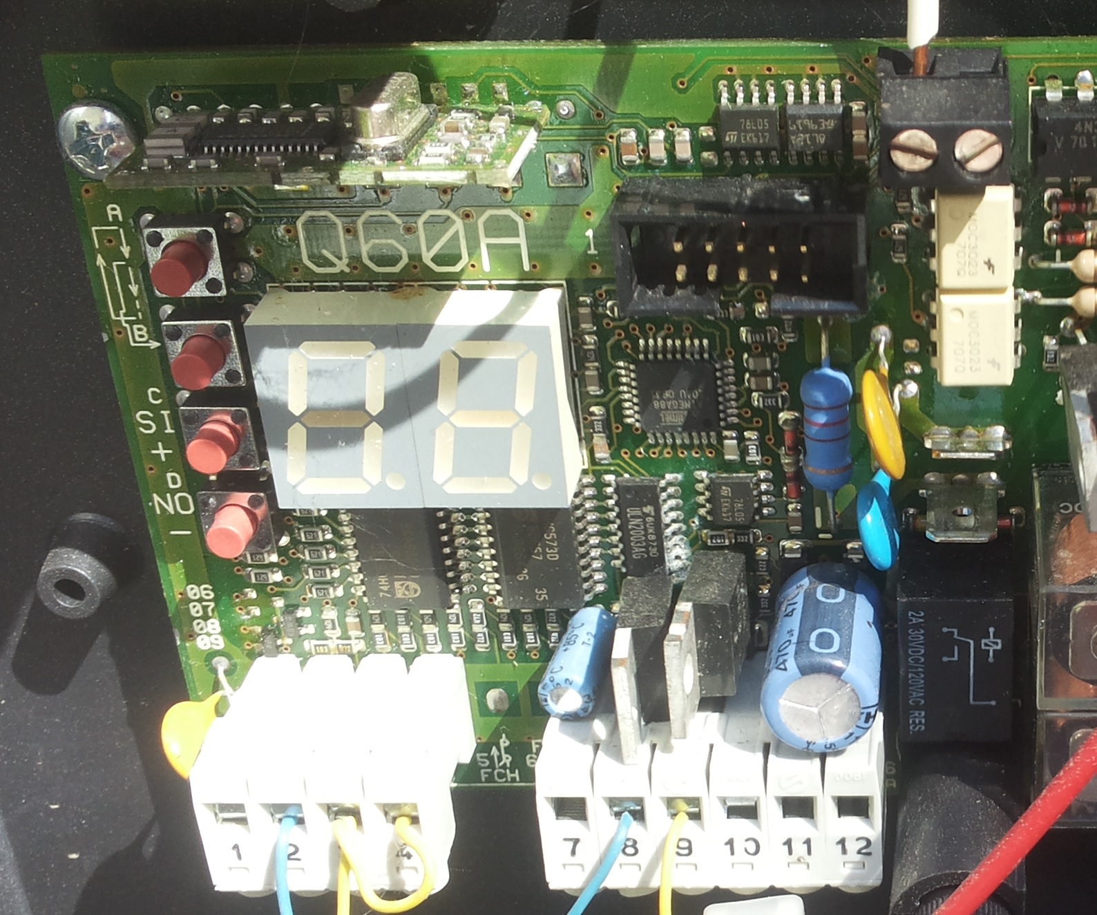

I had an incident where the exterior aerial cable was pulled out of the control box cable gland and also pulled the terminal block off the circuit board.
[Image: q60a-1.jpg]
I am pretty sure I can solder the aerial back onto the board, as there are still copper prongs sticking up, from where the TB was.
However laying loose in the bottom of control box is a small device labelled as T6.6122
[Image: q60a-2.jpg]
Any idea what it this is. Is it part of the TBlock?
The part you are referring to is the crystal of the pll receiver.
Location upper left corner of the board. It is connected to a smaller board that is the radio signal receiver
Without traveling a few miles to have a look. Does it just clip into the RF board, or has it been ripped off its soldered lugs ?
Or does it mean a new board ?
i will post some photos later in the afternoon.
Cheers
    check out the location of the radio board and the crystal.
Thanks for that. Do you reckon the crystal is clip in ?
No the crystal is soldered in the board
Thanks - It looks like a gamble then, I will give it a try and solder it back in place, and see what happens.
