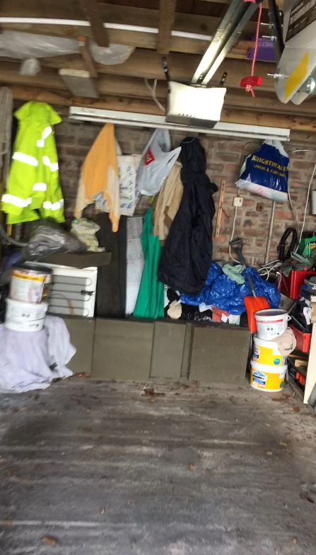

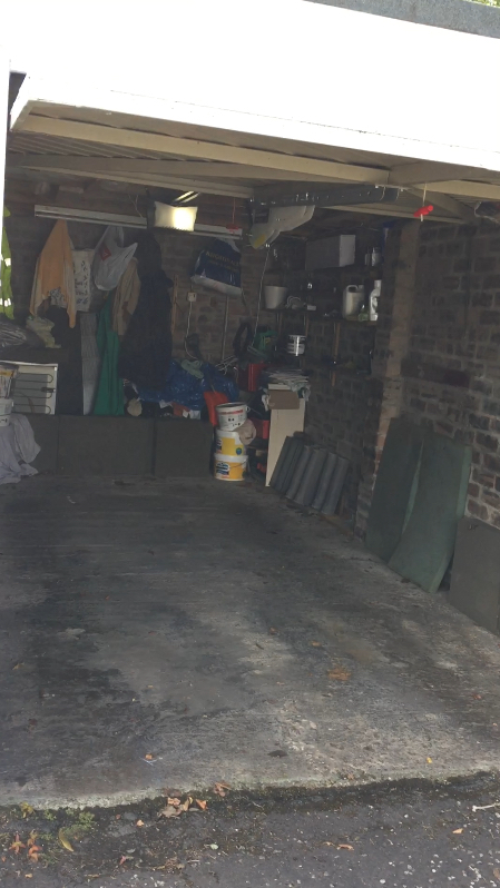

Unfortunately, I'm now in Canada for a bit BUT the garage door is still in operation at my mother's house (and is balanced). That means sadly i can't get any new photos for the time being. I did a video of it opening a while back but it doesn't really show much of the mechanism though i got a few screen grabs (see below) which shows the chamberlain arm connected with the straight bar to the trackway.
The garage door was playing up a little before I left for Canada (was fully opening, hitting the ceiling, then dropping 6 inches) but that was after lubricating it. So i can only assume that took some of the 'strain' out of things, and made the opener think it was 'lighter' than it actually was. The up and down travel adjusters are super sensitive but i managed to find a 'sweet spot' and set it so the door doesn't open fully and leaves about 4 inches from the top of the garage door frame when open, meaning the door will never open fully and cause the problem I was facing.
In your opinion, is this an OK solution? And is using the straight bar (which you can barely see in the photos...apologies!) OK, or should i have persevered with the curved bar for this type of installation?
